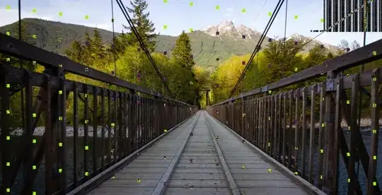

I have recently upgraded Ubuntu 19.10 to latest LTS Ubuntu 20.04. After updating, I get serious artifacts on my screen. Every time I reboot (or log-in), my screen is fuzzy or scrambled (picture attached):
fuzzy image
This is temporary. The fuzzy screen goes away when I change the background. But it reappears the moment I reboot or log back in.
I have Intel HD Graphics 520 (Skylake GT2).
The output of lspci -nn |grep -E 'VGA|Display' is:
00:02.0 VGA compatible controller [0300]: Intel Corporation Skylake GT2 [HD Graphics 520] [8086:1916] (rev 07)
Update:
On enabling Wayland in Ubuntu 20.04 and logging in to, these artifacts are however cured.
This is okay for now, but I am not sure about Wayland as I have not yet used it before.
Is there a way to correct the graphic issue with normal Ubuntu startup?

I solved my fuzzy graphics issue which is related to Intel Drivers. A bug is also reported on Intel driver artifacts. Following the answer provided here this command line solved the issue:
sudo apt purge xserver-xorg-video-intel
Reboot and everything is back being normal.

Same problem here with an Intel UHD Graphics 630 (Desktop) after upgrading from 19.10 to 20.04.
Completely solved by deleting a custom Intel Xorg configuration file I had created in the past ― on my setup it was /etc/X11/xorg.conf.d/20-intel.conf, and contained:
Section "Device"
 Identifier "Intel Graphics"
 Driver "Intel"
 Option "AccelMethod" "sna"
 Option "TearFree" "true"
EndSection
