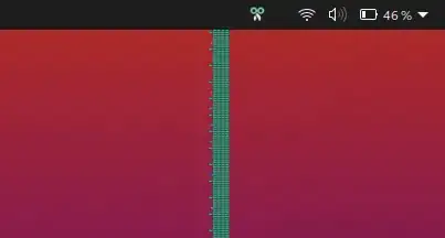

I have been using Ubuntu 20.04 (dual booted with Windows) happily for a year. Recently, I didn't run Ubuntu for a week and was using Windows for long. Then I booted up Ubuntu and I started finding weird behavior at some places.
  1. There were weird graphics glitches at some places (full screen snap):

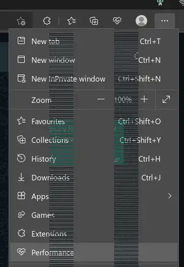

  3. Brave and chromium browser were super slow. Edge browser was fine buts is Developer tools were also super slow. It was also showing such weird graphics:

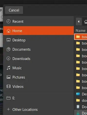

  5. I used to take screen shot with Ctrl+Shift+PrintScreen key shortcut of Ubuntu. It used to turn the cursor to plus (+) sign which I can drag it across screen and then do Ctrl+V wherever desired. While taking screenshot for this post I tried the same but the plus (+) shaped cursor did not appear for long. Then when it appeared, it only appeared when I moved it at the Ubuntu bottom taskbar. So I tried doing normal printscreen to image and open that image in Kolourpaint app. But while doing that I realized left side menus of open Image dialog of Kolourpaint app are unresponsive:
    (I fixed it by running r command in Alt+F2 Ubuntu command box by re-running whole UI)
