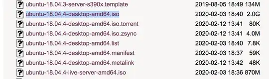

Update 1: to be specific, I downloaded the Desktop version onto my USB stick. I downloaded the .iso version highlighted here, the one that is 2.0G:
And you can find the list here.
