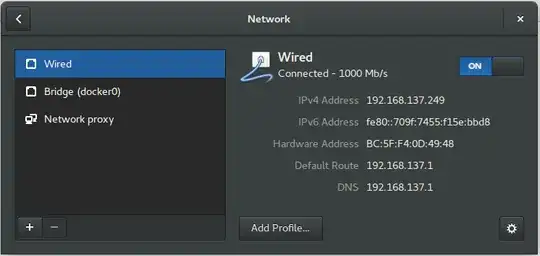

  1. In the All Settings>Network I don't see anything wifi-related. Does my desktop need to be setup for to use wifi somehow?
