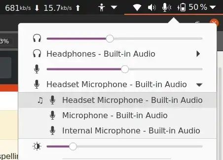

Complete solution (Mic + Audio)
[UPDATE]: This morning I was completely able to fix this issue where you can now use all your headsets with microphones by replacing all the above lines with the following:
options snd_hda_intel model=dell-headset-multi
Even if your system is not a dell system, it'll still work since the setting is for Realtek ALC295 and not a particular brand in general.
Shutdown and cold boot. (Won't work on a restart!)
Once you do this and try plugging in a headphone. Now it will give you an option to choose what type of device it is.
THIS IMAGE HERE
P.S -> They are visible in notification panel due to Gnome Extensions. You can go in settings and choose your preference.
