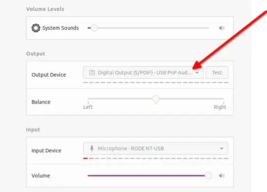

After upgrade, its still is displayed, but there is no sound: enter image description here
There is either no sound at all, or the sound comes from my laptop. Headphones are plugged in.

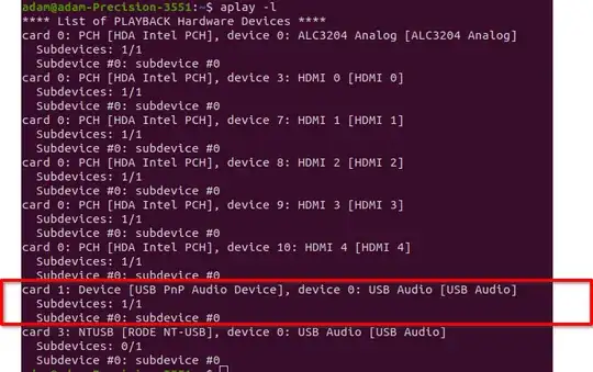

This is my audio device that plays no sound:
I of course checked that my headphones are turned on and are still working on another machine.
