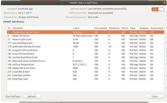

Fsck and smartctl did not show any errors.

Edit 1. Screenshot of SMART test SMART
