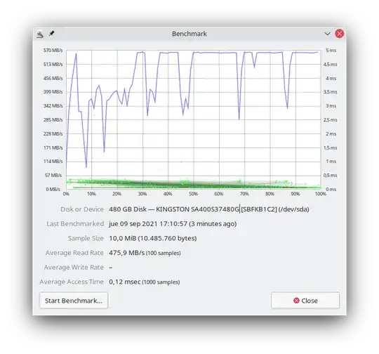

the command sudo smartctl -t short -a /dev/sda say that my SSD has a SSD_Life_left of 004, this does worry.
chris@k21:~/Documents/web/logindo$ sudo smartctl -t short -a /dev/sda |grep SSD_Life_Left
231 SSD_Life_Left           0x0000   004   004   000    Old_age   Offline      -       96
Gnome disk (gnome-disk-utility) enter image description here enter image description here
