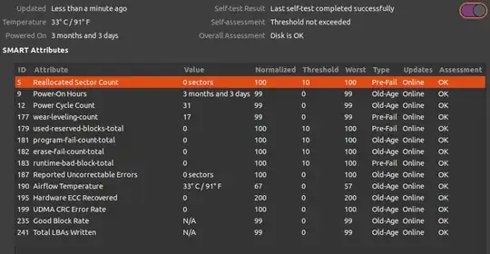

SSD Disk SMART data:
This are typical symptoms of:
  1. Bad spinning drive, bad sectors Or
  2. Using swap memory, so all the system slows down. Maybe you're using way more memory than you physically have and the system is using swap.
