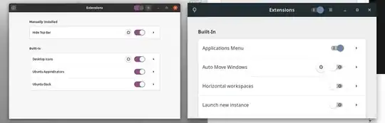

Now I need the icons visible and cannot find an option in my system to do so. The site here explains how to achieve this by checking the option in the Extensions application like in the picture below on the left hand side.
Problem is, in my Extension app the option "Desktop Icons" is missing (picture below on the right). It's also not in the Tweak Tool.

To get your desktop icons back, install gnome-shell-extension-desktop-icons.
heynnema
  • 73,649
Ubuntu 20.04 doesn’t have desktop icons by default. So you need to install a GNOME Shell extension yourself.
You can install it for every users of the computer by installing the gnome-shell-extension-desktop-icons package (this is heynnema’s answer).
But you can also install it only for you, the current user. For this, you just need to go to the GNOME extensions website and install whatever extension you want. I would suggest for example DING. You also have Desktop Icons. It’s easy to remove extensions after installing them, so just test them. However, make sure you don't have two of these extensions enabled at the same time, for example using gnome-tweaks, or you will probably experiment conflicts.
