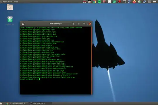

screenshot added for clarityI've just upgraded from 18.04 to 20.04 and use gnome flashback(metacity) as my desktop. Before I updated I had been able to remove the 'home' and 'rubbish bin' icons from my desktop, as I like the clean look. Today I have spent most of the afternoon trying to remove these annoying and unnecessary icons from my desktop!I would be very grateful if anyone could advise me as to how to do it!
Thanks
edited to show result of comment 12/08/20 @WU_TANG I tried gsettings set org.nnemo.desktop show-desktop-icons false as can be seen below -- no result!
    (base) matt@zakk-jr:~$ gsettings list-recursively | grep icons
org.nemo.icon-view labels-beside-icons false
org.gnome.gnome-flashback.desktop show-icons false
org.cinnamon.desktop.interface menus-have-icons true
org.cinnamon.desktop.interface buttons-have-icons false
org.cinnamon.desktop.interface toolbar-icons-size 'large'
org.gnome.gnome-flashback.desktop.icons icon-size '48px'
org.gnome.gnome-flashback.desktop.icons column-spacing uint32 10
org.gnome.gnome-flashback.desktop.icons show-home false
org.gnome.gnome-flashback.desktop.icons sort-by 'name'
org.gnome.gnome-flashback.desktop.icons show-trash false
org.gnome.gnome-flashback.desktop.icons placement 'auto-arrange-icons'
org.gnome.gnome-flashback.desktop.icons row-spacing uint32 2
org.gnome.gnome-flashback.desktop.icons extra-text-width uint32 48
org.gnome.shell.extensions.openweather use-symbolic-icons true
org.gnome.shell.extensions.topicons icon-size 24
org.gnome.shell.extensions.topicons icon-saturation 0.40000000000000002
org.gnome.shell.extensions.topicons tray-pos 'center'
org.gnome.shell.extensions.topicons icon-contrast 0.0
org.gnome.shell.extensions.topicons icon-spacing 12
org.gnome.shell.extensions.topicons tray-order 1
org.gnome.shell.extensions.topicons icon-brightness 0.0
org.gnome.shell.extensions.topicons icon-opacity 220
org.gnome.desktop.background show-desktop-icons false
org.gnome.desktop.interface menus-have-icons false
org.gnome.desktop.interface buttons-have-icons false
org.gnome.desktop.interface toolbar-icons-size 'large'
org.gnome.shell.extensions.desktop-icons show-trash false
org.gnome.shell.extensions.desktop-icons icon-size 'standard'
org.gnome.shell.extensions.desktop-icons show-home false
org.nemo.desktop show-desktop-icons false
org.nemo.desktop show-orphaned-desktop-icons false
org.gnome.gnome-panel.general prefer-symbolic-icons false
Further edit to add information: I set up another user on this machine, and when I ran ' gsettings set org.gnome.gnome-flashback.desktop show-icons false' the icons disappeared, so now i'm really confused!!

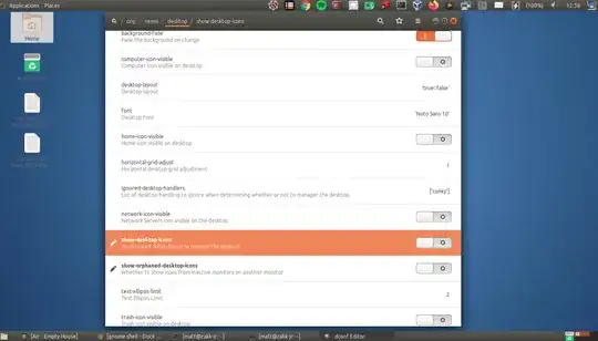

further edit to show dconf-editor settings : enter image description here

I know the question is a bit old, but I was able to remove the desktop icons in GNOME flashback Ubuntu 20.04 with dconf-editor:
  1. Open dconf-editor
  2. Go to /org/gnome/gnome-flashback/desktop/show-icons and change the value
