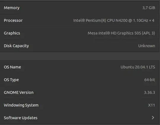

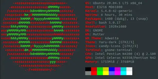

My laptop keyboard stopped working after an update to Ubuntu 20.04. The solutions mentioned in other threads, such as (re)installing xserver-xorg-input-all, changing stuff in the GRUB menu, changing the keyboard layout/language or enabling/disabling stuff in the "Universal Access" menu (such as AccessX) didn't worked at all. My external keyboard works fine, but I need to get the default keyboard working again.
neofetch screenshot
"about" settings screenshot
