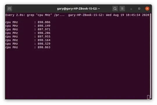

Here is my current frequencies
CPU Frequencies
Here is the current cpufreq-info output, see how it's set to only be 900MHz

Results of ps auxc | grep -i therm
root         185  0.0  0.0      0     0 ?        I<   15:07   0:00 acpi_thermal_pm
Results of free -h
total        used        free      shared  buff/cache   available
Mem:           15Gi       2.0Gi        11Gi        80Mi       1.6Gi        13Gi
Swap:         2.0Gi          0B       2.0Gi
Results of sudo turbostat --Summary --quiet --show Busy%,Bzy_MHz,PkgTmp,PkgWatt,GFXWatt,IRQ --interval 6
Busy%   Bzy_MHz IRQ PkgTmp  PkgWatt GFXWatt
19.69   866 11218   45  10.86   0.00
19.75   866 10087   44  11.01   0.00
20.24   864 32081   44  10.98   0.00
19.89   865 9915    45  10.88   0.00
19.57   866 9581    44  10.84   0.00
19.51   867 28248   44  10.80   0.00
19.03   866 8652    45  10.77   0.00
19.19   867 29111   45  10.75   0.00
21.04   867 11219   45  10.92   0.00
21.17   870 10631   46  10.92   0.00
19.42   866 29364   45  10.81   0.00
19.50   867 8938    46  10.84   0.00
21.07   868 10832   44  10.90   0.00
19.96   867 30598   45  10.84   0.00
19.36   867 9359    45  10.83   0.00
20.50   868 52384   46  10.86   0.00
21.44   868 12888   46  10.90   0.00
19.73   800 1079    46  10.55   0.00
Result from sensors
BAT0-acpi-0
Adapter: ACPI interface
in0:          15.98 V
curr1:         0.00 A
coretemp-isa-0000 Adapter: ISA adapter Package id 0: +40.0°C (high = +84.0°C, crit = +100.0°C) Core 0: +40.0°C (high = +84.0°C, crit = +100.0°C) Core 1: +39.0°C (high = +84.0°C, crit = +100.0°C) Core 2: +37.0°C (high = +84.0°C, crit = +100.0°C) Core 3: +38.0°C (high = +84.0°C, crit = +100.0°C)
acpitz-acpi-0 Adapter: ACPI interface temp1: +40.0°C (crit = +128.0°C) temp2: +40.0°C (crit = +128.0°C) temp3: +85.0°C (crit = +128.0°C) temp4: +85.0°C (crit = +128.0°C) temp5: +25.0°C (crit = +128.0°C) temp6: +127.0°C (crit = +128.0°C)
Results from sysctl vm.swappiness
vm.swappiness = 60
Results from dpkg -l *freq* | grep ii
ii  cpufreqd          2.4.2-2ubuntu3 amd64        fully configurable daemon for dynamic frequency and voltage scaling
ii  cpufrequtils      008-1.1        amd64        utilities to deal with the cpufreq Linux kernel feature
ii  indicator-cpufreq 0.2.2-0ubuntu3 all          CPU frequency scaling indicator
ii  libcpufreq0       008-1.1        amd64        shared library to deal with the cpufreq Linux kernel feature
Results from ls -al /usr/share/gnome-shell/extensions
total 20
drwxr-xr-x 5 root root 4096 Apr 23 03:35 .
drwxr-xr-x 7 root root 4096 Aug 18 14:29 ..
drwxr-xr-x 2 root root 4096 Aug 19 15:00 desktop-icons@csoriano
drwxr-xr-x 3 root root 4096 Apr 23 03:35 ubuntu-appindicators@ubuntu.com
drwxr-xr-x 3 root root 4096 Jul 30 16:43 ubuntu-dock@ubuntu.com
Any help would be greatly appreciated, the machine is practically unusable with speeds this low.

Welp, it's fixed. I'm happy that the issue is fixed, but it's fixed mysteriously.
Attempting to try @Doug Smythie's answer and re-enabling the intel-pstate governor and rebooting, my processors are now working optimally with nearly full processing power.
All I had to do was /etc/default/grub file and change GRUB_CMDLINE_LINUX_DEFAULT to GRUB_CMDLINE_LINUX_DEFAULT="intel_pstate=enable quiet splash"
Once I rebooted and tested my CPU speed, it was fine. Restarted a few times and it sticks.
The mystery is that this was the Governor I was using before and I couldn't get these results previously. Thanks for all the help.
