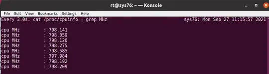

I would really like to find out why my cpu's keep reverting back to a cpu powersave mode after I get a kernel update then reboot.
I cleaned my laptops vent but this seems to happen whenever a new kernel is updated and installed.
I type in watch -n1 "cat /proc/cpuinfo | grep MHz" (to see cpu's)
pic 1
