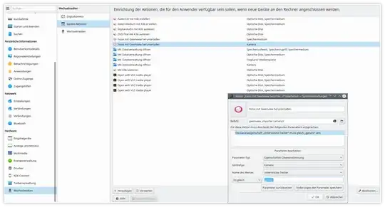

What helped me was disabling auto mount in the KDE settings:kde settings Wechselmedien
I did so by removing the gphoto text, which is selected in the screenshot. I also did so in the Mit Dateiverwaltung öffnen entry.
I know this isn't very elegant, but it works.
