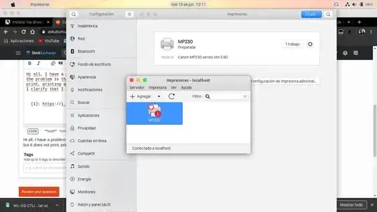

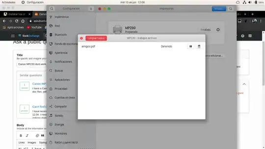

I have a problem with my Canon PIXMA MP230.
The problem is that when I want to print a file, it goes to the print queue, but it does not print, printing appears stopped.
I clarify that I have the drivers installed but it still does not work.
stoped
