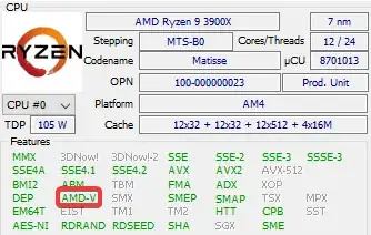

When researching this error, and from reading the official WSL 2 install guide from Microsoft, the error always seems to be because the system doesn't have virtualization enabled in the BIOS. This is really confusing as I have checked over 4 different times if I missed any virtualization setting in my BIOS, and have verified it is all enabled. I also have confirmed I have the NX feature enabled as well. Even HWiNFO detects I have virtualization enabled:
Screenshot of HWiNFO's results
