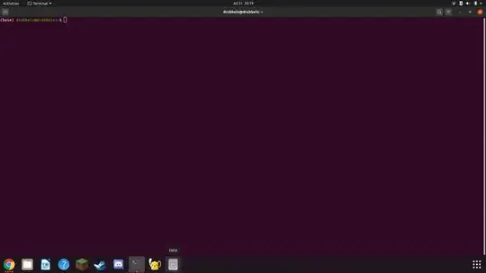

Today, I updated my Ubuntu 18.04 machine to 20.04. My laptop has both an SSD (where the OS is located) and a larger HDD (where most of my data is). Since the update, an icon for the hard drive appears permanently in the dock. This was not the case before I updated.
A screenshot showing that an icon representing my HDD, labelled 'Data', is present in the dock
It does not have any open instances (indeed, it can't have any 'opened instances' of its own - clicking it just opens the HDD's root directory in the file explorer), so that's not its excuse for appearing in the dock.

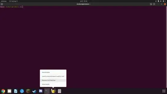

Ordinarily, if I don't want a particular icon in the dock, I can easily remove it:
A screenshot showing the context menu for the 'Geany' program icon in my dock, which includes an option labelled 'Remove from Favorites'

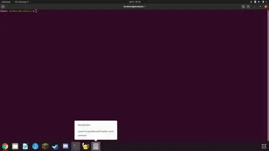

However, this does not seem to be possible with the HDD icon:
A screenshot showing the context menu for the 'Data' HDD icon in my dock, which does not include a 'Remove from Favorites' option

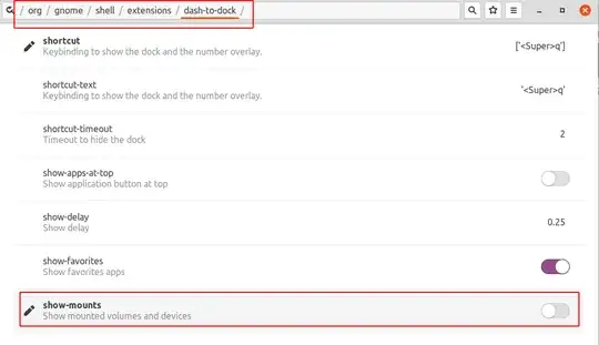

Open dconf Editor.
If dconf Editor is not on your system, do:
sudo apt update
sudo apt install dconf-editor
Adjust the following setting...
