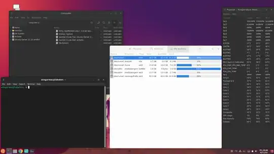

Ubuntu 22.10 with Cinnamon desktop 5.4.12 not showing System Monitor 42.0 with same theme:
sysmon-theme
Ubuntu release updated yesterday 3th november 2022 from 22.04 using lightdm and Cinnamon to Kinetic.

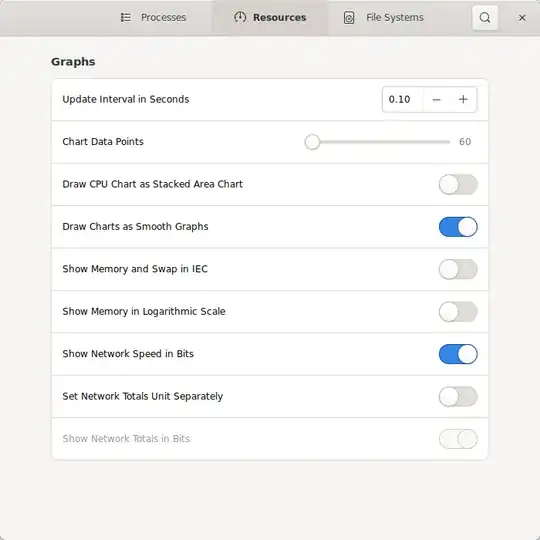

I didn't found any settings to allow to change it:

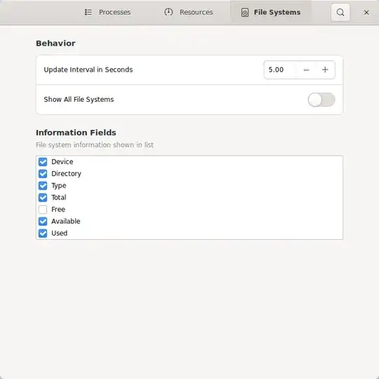

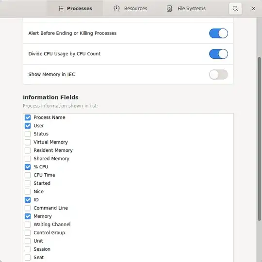

processes-settings
ressources-settings
filesys-settings
How can I make it use the same theme?

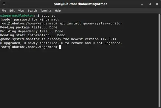

I installed it with apt install gnome-system-monitor: apt-install-gnome-system-monitor

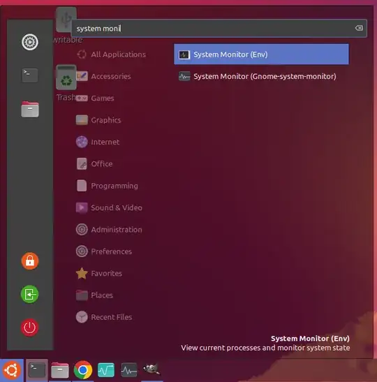

With same results for both described as follow in the Cinnamon menu:
(I do not know which one is snaps so I tried both)
cinnamon-sysmon-search

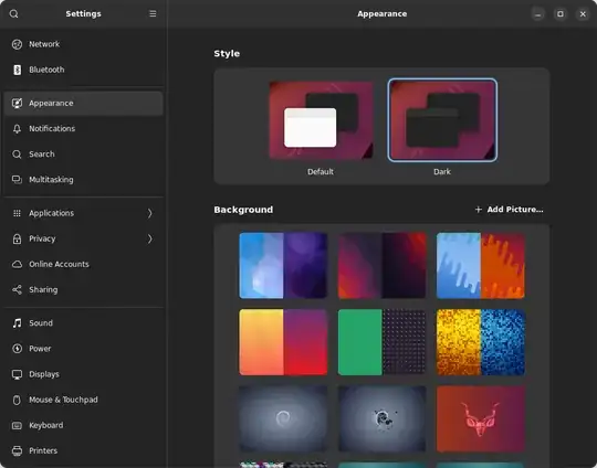

After some tests I found a solution.
I first took a look to the Cinnamon System Settings in de menu.
It was wrote as comment "Control Center".

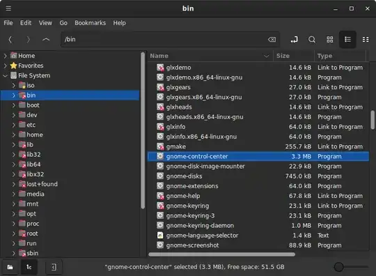

Since gnome-system-monitor is from gnome I search for the /bin/gnome-control-center on my current install. I found it and tried to open it:
From there I could set the dark appearance:
gnome-control-center-apearance

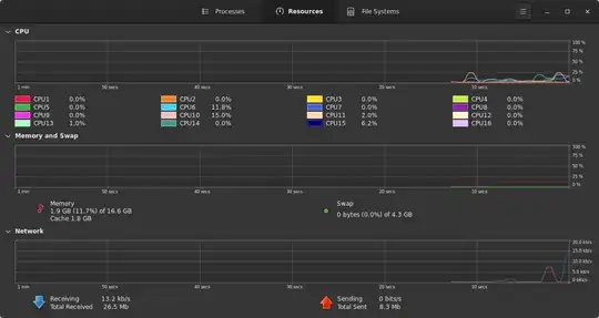

After that the gnome-system-monitor was also with a dark theme:
sysmon-dark-theme

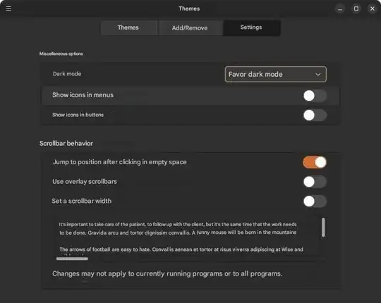

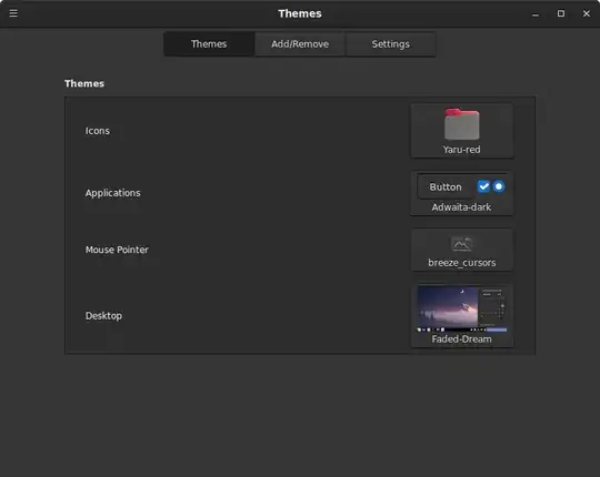

I found this additional setting that made all software (including those of GNOME that were not using the system theme) use the dark theme (Dark mode).
Themes settings
