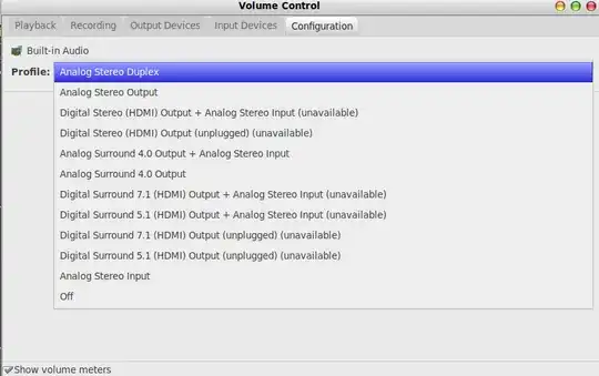

In your case I'd expect some HDMI devices. If these are not available, then it is a driver problem - pulseaudio needs the data from alsa, so if alsa can't see it, pulseaudio can't either.
If those devices exist, issue
pactl list sinks
in order to check out which devices will accept audio signals. In such cases I usually rely on installing pavucontrol which is the UI friontend for pulseaudio.
There you can select the devices needed:

After the OP posted the necessary output some hints:
  1. alsa can see the cards. So they exist and could be used.
  2. Pulseaudio does NOT recognize them.
This can be seen in the sinks lists as well as in pavucontrol. Still not clear if pulseaudio recognized the cards or not. The output of
pacmd list-cards
would be helpful.
One way to test is to check all the cards (in case list-cards delivers something) by doing:
speaker-test -D hw:HDMI,N -c 2 -r 48000
If one of those tests work (iter thru all cards you have, c is the card number) try to connect it with pulseaudio (the output MUST be listed in the pacmd list-cards list:
pacmd set-card-profile alsa_card.pci-0000_00_1b.0 output:hdmi-stereo-extra1
Both commandlines are examples, just to give you the gist: You need to test which cards are working, then you link the alsa information to the working/desired output of pulseaudio.
