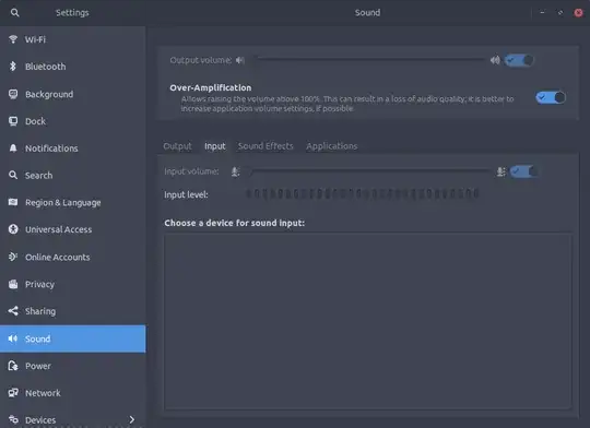

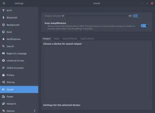

I just upgraded my Ubuntu desktop 16.04 LTS to 18.04 LTS. After that it's not detecting sound devices. I have Lenovo laptop. Settings/Sound/Output
Settings/Sound/Input

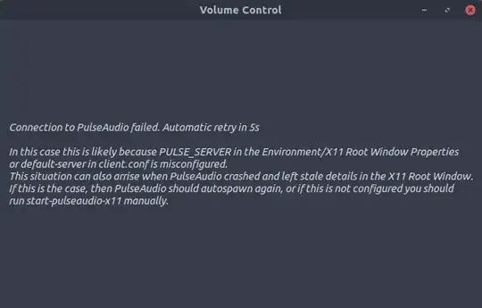

pavucontrol
pavucontrol 3.

I had a similiar issue that turned out to be a permissions problem with the pulse audio conf file, when I upgraded my Lenovo T440pclaptop to 17.10 last year.
The fix that finally worked for me (sorry, I cant find the original source for reference) was
killall pulseaudio; rm -r ~/.config/pulse/*
hth

I had the same problem -- no sound after upgrade to 18.04.1 LTS -- and no audio profiles showed up. This eventually solved the problem:
  1. delete .config/pulse/ and .pulse (the latter might not exist)
  2. reboot
  3. pulseaudio --start
  4. pavucontrol, go to Configuration tab and choose profile analog stereo output
  5. gnome-alsamixer click unmute
I don't know if all these steps are necessary, but just killing pulseaudio and removing the pulse configuration files did not fix this. Without the reboot, alsamixer was already unmuted, yet there was no sound.

Besides purging pulseaudio and pulseaudio-utils and its local lonfigs, I also had to remove all local gstreamer configs. This was on a Dell Latitude E5570.
apt purge pulseaudio.*
rm -r ~/.config/pulse/ ~/.cache/gstreamer-1.0/ ~/.local/share/gstreamer-1.0/
apt install pulseaudio
