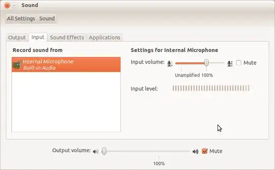

d. Testing
  • Apart from your choice of indicator, you can also confirm mute via the following:
Mic Input
  • Click on the volume icon on the top right, and sound settings at the bottom:
  • Switch to the "Input" tab.
  • Now have fun pressing the Mic Mute button, you should see it reflected in:
    1. The Mute checkbox in the window
    2. Notification bubbles (won't appear instantly if you press the Mic Mute more than once every few seconds!)
    3. Your chosen indicator: the blinking power button light or the built-in Mic Mute light.
