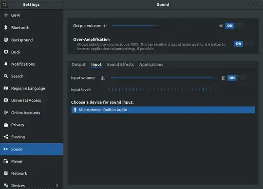

The system settings show the following :
NOTE: The device changes to Internal Microphone - Built-in Audio when I unplug the headset.

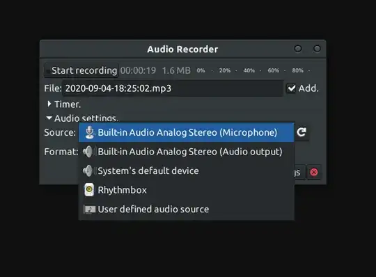

For testing purposes, I tried recording audio using the default Audio Recorder application :
- Using
Audio Outputas theSource, I am able to record music that is being played. - Using
Microphoneas theSourcein theAudio Recorder, with headset inserted, the recorded audio has nothing but white-noise. - Using
Microphoneas theSourcein theAudio Recorder, with headset not inserted hence the system-microphone, its again just the white noise. The difference, this time being, that the white-noise is a bit more louder.
