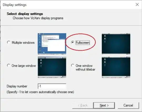

  1. Go to https://sourceforge.net/projects/vcxsrv/ to download VcXsrv Windows X Server. The version I am using is 1.20.14.0. Install it in Windows.
  2. Start VcXsrv by running XLaunch in Windows (if a previous VcXsrv is running, exit it. The settings of VcXsrv matter). Select "Fullscreen" in the first page. Fill up the "Additional parameters for VcXsrv" field in the third page with -ac -wgl -dpms.
When VcXsrv starts, you might see a whole black screen. That's the effect of full screen without contents yet. Press Alt-Tab to switch to Ubuntu command line in WSL.
  1. Run dbus-launch --exit-with-session gnome-session
  2. Go to the full-screen VcXsrv window. The Ubuntu GNOME desktop should show up now. Enjoy!
