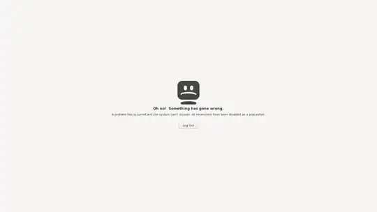

I'm using Ubuntu 22.04.01 on WSL2 on Windows 11 22H2 with Systemd support. However, though I've followed all the instructions mentioned in this answer, I still can't start gnome-session properly. It only shows an "Oh no! something went wrong!" sign like this.
I checked the logs and saw the following messages, not sure if it is relevant:
misc dxg: dxgk: dxgkio_query_adapter_info: Ioctl failed: -22
