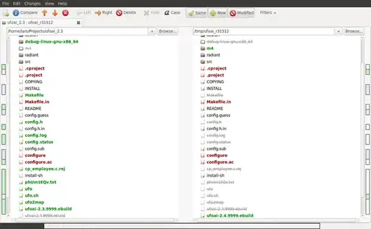

Meldinstall meld
Meld is a tool that can compare and merge files and directories. It is a GUI analog to the standard diff install diffutils and patch install patch command line tools. (See man diff and man patch for more details on those)

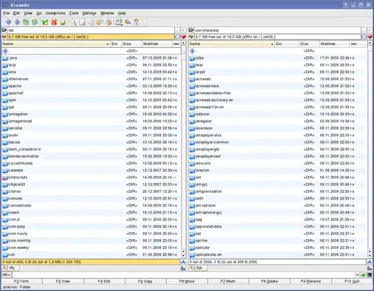

Krusaderinstall krusader
Krusader is a free tool (available in the Software Centre) that shows folder contents in comparison and you can synchronize with a lot of different options. You can filter while synchronising and comparing.
Krusader
To compare file contents you simply mark two files select "file" > "compare content" and they are compared on a letter by letter basis. the default comparing tool used by krusader is the default KDE tool "Kompare". You can set krusader to use any other comparison tool - like for example one of the above.
This is the most complete solution I ever found and it's very convenient. And it supports all the function keybindungs used by midnight commander (norton commander syntax).

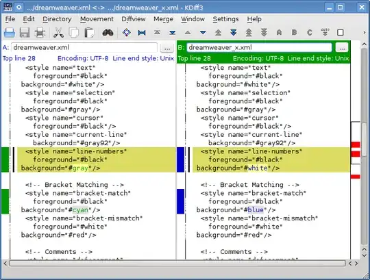

KDiff3 install kdiff3
It is a graphical front-end to diff for KDE users (or if you don't mind using Qt apps).
kdiff3
