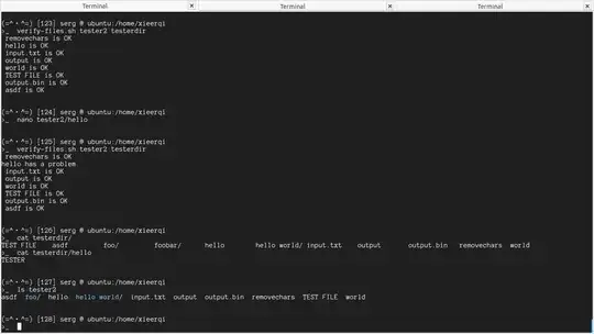

Script in Action
I've tester2 as source directory and testerdir as destination, where I've already copied files. On line 123 I run the script to verify files being copied over. On line 124 I change contents of tester2/hello file (change its contents from "TEST" to "TESTER"). On line 125 you can see that the script detects that file hello has been altered/changed in size/corrupt , and copies the file over again. In line 126 you can see me verify that the hello file in destination folder matches that of source folder. enter image description here
