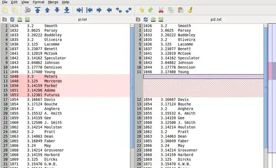

Here is an example diffuse window:
You clearly see the differences between the two text files. Using the blue arrows on the top that go up or down you can move between the differences found. The blue arrows on the top that go left and right can be used to move the text from left to right and the other way round. The icons with two little blue arrows are used to merging the two files.
If you double click, you can directly edit the text.
