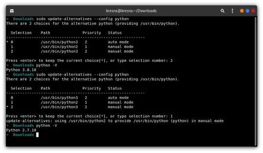

Finally, I found a website describing HPLIP problem on ubuntu exactly as I had at here https://ubuntuhandbook.org/index.php/2021/07/install-latest-hplip-ubuntu-20-04-fix/
The problem is because by default HPLIP installer using python at /usr/bin/python and that refers to python2.7 which is unrelated with the installed pyqt5 at my python3
So based on that site, I choose to use update-alternatives to switch python version to python3 when the installer using /usr/bin/python
sudo update-alternatives --install /usr/bin/python python /usr/bin/python2 1
sudo update-alternatives --install /usr/bin/python python /usr/bin/python3 2
the first command is to add python2 at option number 1, and the second one is to add python3 at option number 2.
Here's the screenshot of when I switch to python3 and python2, before starting the installation again using python3 as the default one
example switch python version

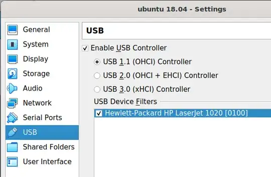

It seems Ubuntu 20.04 is not supported by hplip 3.20.5 and below hplip releases. At least, Ubuntu 20.04 has not been mentioned on hp's Developer Portal | Release Notes page. The last mentioned Ubuntu version is 19.10 at the time.
So the optimal solution in my case is to wait for newer hplip release and use 18.04 VM on VirtualBox with USB 1.1 passthrough enabled for my hp 1020 printer until newer hplip released.
