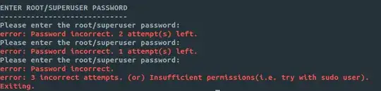

I am running in my shell:
./hplip-3.18.7.run
Then it wants me to enter the root password, but does not accepting it!
Anybody know what this is?
If I run the script with sudo sudo ./hplip-3.18.7.run , then it tells me at some step in the installation process: warning: hp-systray should not be run as root/superuser.

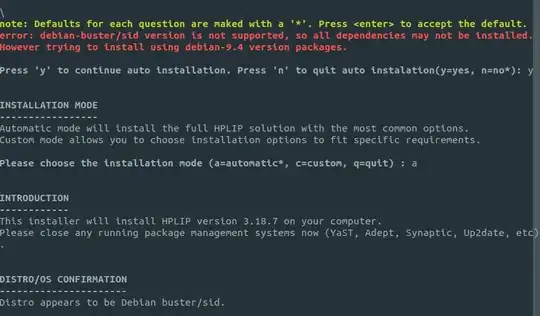

This what the installer outputs at the beginning:

From hplip source-code we can learn the following about auth. Auth is performed in base/password.py file.
The main AUTH_TYPES are for:
  • Debian - su
  • Ubuntu - sudo
During chat session and in comments we have discovered interesting moments:
  • the first check is made python platform module. On Ubuntu it should return "Ubuntu".
  • second distro check - lsb_release -i | cut -f 2 returns "Ubuntu"
  • third distro check - cat /etc/issue | awk '{print $1}' | head -n returns "Ubuntu".
But OP has installed Anaconda in home folder, and added this directory to the path. And what is interesting - in such case python -c "import platform;print platform.dist()[0]" returns "Debian" (!!!) on distro check. So installer tried to use su. But root account is disabled on Ubuntu by default, so problem arises ("Please enter the root/superuser password:" instead of "Please enter the sudoer (%s)'s password: ").
Conclusion
Always check your $PATH variable for Python versions.
Many software in Ubuntu depend on Python. APT does not know about Anaconda, so system may have unpredictable behaviour with third-party pythons and pips. I can recommend to exclude third-party pythons from $PATH variable.
Then binary hplip installer should work normally. And you can follow my instruction then.
