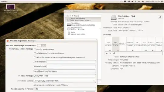

Hiding partitions from Nautilus via »Disks«
In Ubuntu 12.10 and onward, there is a utility called Disks which shows all the available disks and allows to modify mount options for each partition.
Amongst the various options, you can decide if the partition will be mounted at boot time or not, and if it will appear in the user interface. Admin privileges are needed to apply changes.
Gnome Disks screenshot

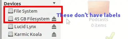

First, you must know what disks and/or partitions you want to hide. From what I’ve observed, Nautilus will either present these devices by label. If it does not have a label, then the device will be associated with the disk/partition size.
Look at the image below. The ones in the red box don’t have labels. File System is always the current /root partition, while the 45 GB File System is a partition that does not have a label. In this example, it is the /root partition of my Ubuntu 10.10 (I’m running on Natty Narwhal but have kept my Maverick Meerkat as a backup of sorts). The other two – Lucid Lynx and Karmic Koala - are the labels of my 2 NTFS partitions.
The labels are important in case you are not familiar with how Linux refer to these devices. In Windows, whether it is a disk or a partition, they are called by letters – C or D – and so on. Linux has a more specific naming system. It is normally sdaX or hdbY, where X and Y are the numbers of the partitions on the sda or hdb drives, respectively. Thus, if there are 3 partitions on sda drive, then there will be sda1, sda2 and sda3. Windows will more likely just call it C, D, and E.
Now mount all of your drives and/or partitions. You know how to do that, don’t you? Click the name in Nautilus and it will mount it for you. I suggest you unmount and remove all removable drives to avoid confusion.

Thanks for this, very handy tutorial. I actually found a much easier way to do this in Ubuntu 14.04
  1. Hit the super/windows key
  2. Type and open disks
  3. Select the partition you want to hide so it becomes orange
  4. select the cog/settings/advanced settings icon. Click Edit Mount Options
  5. Turn auto mount off
  6. Uncheck both Mount at Startup and Show in user interface
  7. Save & Reboot
No terminal required, maybe this is a new feature for 14.04 ? Not sure either way this was much easier and effective.
