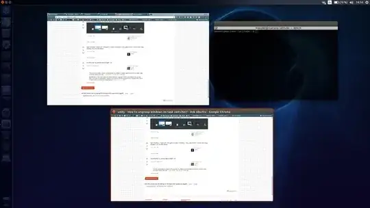

As of Ubuntu 16, you can also press Start + W, which will bring this: enter image description here It's faster than alt+tab task switcher and doesn't group windows.

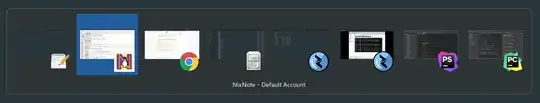

If using Gnome Desktop, you can use extension name: Alternatetab enter image description here
