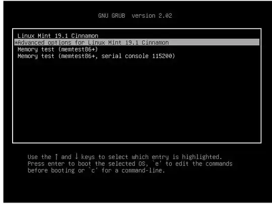

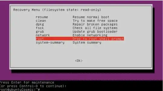

My workaround fix was a bit different, the solution that worked for me is that I enter the kernel in the recovery mode, and then I manage to fully uninstall the docker because the docker doesn't stuck there. i think from whatever kernel you have you can do the same thing but to be honest i downgrade to the 5.4.0-29 just like the above answer. Nevertheless, the problem with the previous answer was that when i try to boot the kernel 5.4.0-29 the containerd stuck at the boot time wherein other versions the stuck happened when you try to execute some docker commands, so let me explain more closely the steps that i made
You'll need to edit your sudo nano /etc/default/grub file remove the "#" symbol at the start of line for
  1. GRUB_TIMEOUT=20 to show the menu for 20 seconds
  2. GRUB_TIMEOUT_STYLE=menu to show the boot menu
then save the file and quit the editor. Next run:
sudo update-grub
sudo reboot
[Enter the boot menu1
enter the recovery mode
pick the root terminal and press ok and the enter
After that you are able To completely uninstall Docker run:
