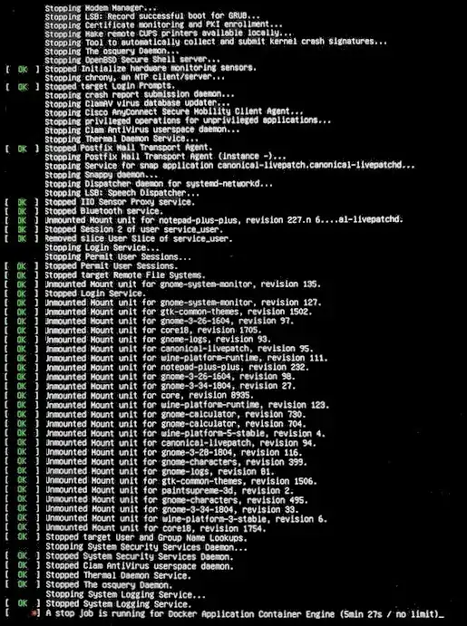

Now every time I reboot/shutdown -- it just won't shut down due to
A stop job is running for Docker Application Container Engine (13min 58s / no limit)

What's your Kernel Version?
I have experienced the same problem with latest kernel in 18.04 (5.3.0-52-generic) and in 20.04 (5.4.0-30-generic).
I have a thinkpad T590.
Apparently switching to a different kernel version helps: See
