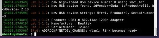

  1. Install rtl88x2bu drivers for the dongles from this repo (as per README, also seen here and here).
sudo apt-get install dkms bc git
git clone https://github.com/cilynx/rtl88x2bu
cd rtl88x2bu
VER=$(sed -n 's/\PACKAGE_VERSION="\(.*\)"/\1/p' dkms.conf)
sudo rsync -rvhP ./ /usr/src/rtl88x2bu-${VER}
sudo dkms add -m rtl88x2bu -v ${VER}
sudo dkms build -m rtl88x2bu -v ${VER}
sudo dkms install -m rtl88x2bu -v ${VER}
sudo modprobe 88x2bu

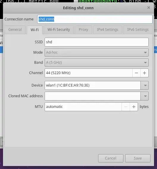

  1. Plug in dongle and setup the wlan1 interface as per the WifiDocs.

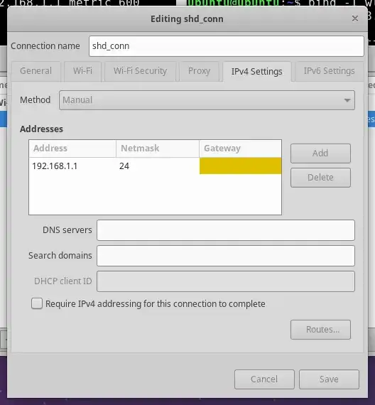

Set ip=192.168.1.1, netmask=255.255.255.0, blank gateway.

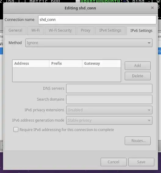

Note: I tried with and without ignoring ipv6 as per this answer.
Note: the netmask is indicated as 24 if I close and reopen the nm-connection-editor.
My config:
conn_config_wifi
conn_config_ipv4
conn_config_ipv6

logs_lsusb_ping
logs_dmesg
