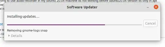

Two days back I upgraded ubuntu 19.04 into 20.04 lts. However, I noticed that the update got stuck at a particular stage saying 'Removing gnome-logs snap'. This window stays forever
Screenshot of the error while updating:
screenshot of the error while updating

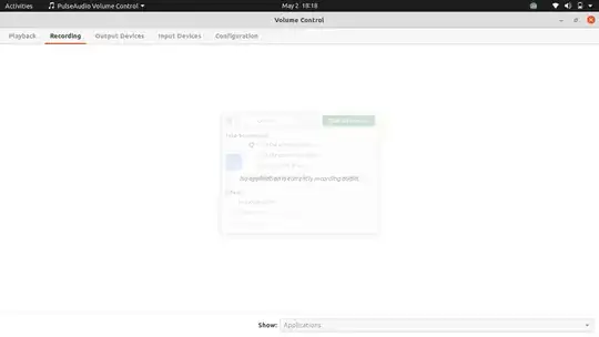

Screenshot of PulseAudio volume controller detecting no recording device:
However, the Telegram desktop client is perfectly recording audio. I don't know what exactly happened with these applications.

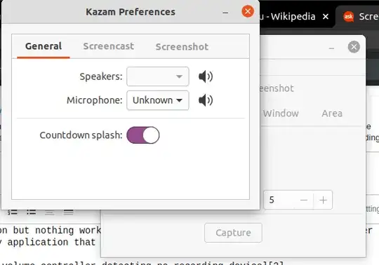

This is the screenshot of Kazam not detecting the recording device:

The issue is due the use of a deprecated python feature. This PR fixes it, so this should be OK if Kazam ever gets updated again.
Anyways, to fix your problem, as I commented here using that PR, you can run
sudo gedit /usr/lib/python3/dist-packages/kazam/pulseaudio/pulseaudio.py
And replace its content with this content.
