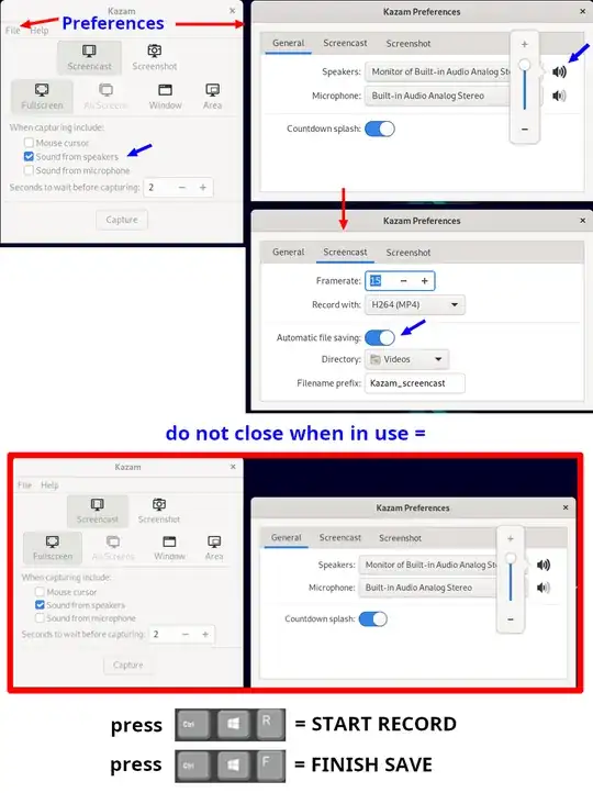

Fix Kazam No Sound on X11 or XORG =
ISRAEL
  • 89
