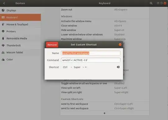

How can I use bash to set it up as if I went in the GNOME GUI to Settings > Devices > Keyboard and set it up manually? example image showing the setup in the GUI

My laptop on which this is already set up using the GUI, I ran a few queries to know what output I should aim for.

$ gsettings get org.gnome.settings-daemon.plugins.media-keys.custom-keybinding:/org/gnome/settings-daemon/plugins/media-keys/custom-keybindings/custom1/ binding
'<Primary><Super>Left'
$ ls /opt
confinedrv  virtio-win.iso  workspace_shortcut_send_to_next.sh
generic@motorbrot:~/Downloads/iso.new$ gsettings get org.gnome.settings-daemon.plugins.media-keys.custom-keybinding:/org/gnome/settings-daemon/plugins/media-keys/custom-keybindings/custom1/ command
'wmctrl -r :ACTIVE: -t 0'
$ gsettings get org.gnome.settings-daemon.plugins.media-keys.custom-keybinding:/org/gnome/settings-daemon/plugins/media-keys/custom-keybindings/custom1/ name
'send to first workspace'
