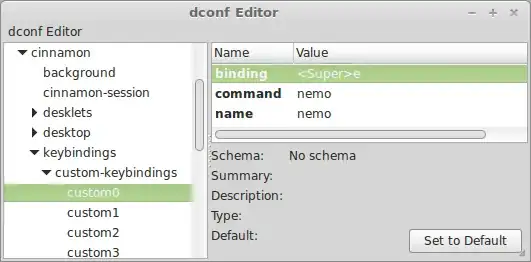

I would like to automate setting some settings, specifically add some keyboard shortcuts to ~/.config/dconf/user. Here is how it looks in dconf-editor:
org.cinnamon.keybindings org.cinnamon.keybindings.custom-keybindings.custom0

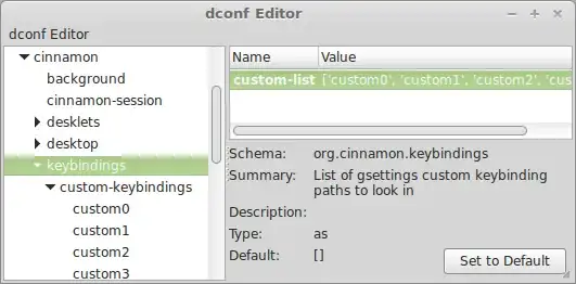

Now gsettings (or dconf) can list the first one:
$ gsettings get org.cinnamon.keybindings custom-list
['custom0', 'custom1', 'custom2', 'custom3']
However, I cannot see a way to then add a new keybinding, or even to read the customX keys.

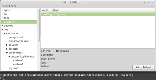

And screenshot after the following command. Note that custom4 does not go to custom-keybindings but to the root.
gsettings set org.cinnamon.keybindings.custom-keybinding:/custom4/ binding '<Super>g'

It's a syntax error. This should work:
$ gsettings get org.cinnamon.keybindings.custom-keybinding:/org/cinnamon/keybindings/custom-keybindings/custom0/ binding
<Super>e
$ gsettings get org.cinnamon.keybindings.custom-keybinding:/org/cinnamon/keybindings/custom-keybindings/custom0/ command
nemo
$ gsettings get org.cinnamon.keybindings.custom-keybinding:/org/cinnamon/keybindings/custom-keybindings/custom0/ name
nemo
To set a new hotkey:
$ gsettings set org.cinnamon.keybindings.custom-keybinding:/org/cinnamon/keybindings/custom-keybindings/custom4/ binding '<Super>g' &&
gsettings set org.cinnamon.keybindings.custom-keybinding:/org/cinnamon/keybindings/custom-keybindings/custom4/ command 'geany' &&
gsettings set org.cinnamon.keybindings.custom-keybinding:/org/cinnamon/keybindings/custom-keybindings/custom4/ name 'Geany'
