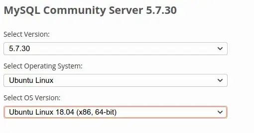

I followed this answer and it works.
First I removed mysql from my pc remove Mysql
Then in download section I choose
And generally I follow the errors.
I also install
sudo apt-get install libaio1
where the error said that need that.
