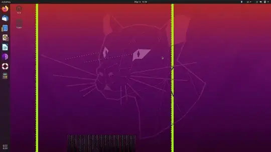

After upgrading to Ubuntu 20.04, my screen has now two vertical green lines (Here a screenshot of my desktop:
nlinn
Does anyone know why is that and how I can get rid of them?

I'm still looking and I seem to have found a solution ... see this thread. Fuzzy graphics after upgrading to Ubuntu 20.04 when using the code
sudo apt purge xserver-xorg-video-intel
At least it worked for me and I no longer have broken graphics on my multi-PGU machine.
