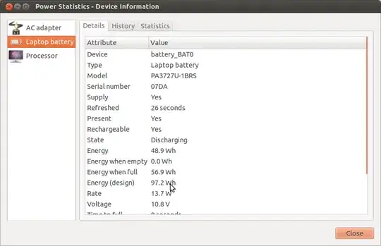

Maybe you're looking for "Rate" in Power Statistics > Laptop battery > Details?
Power Statistics screenshot

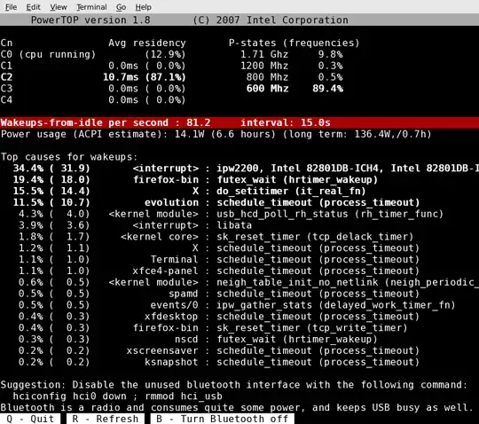

"Linux Power Top" may help (currently available from https://01.org/powertop )

Type sudo powertop in the terminal.

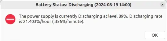

My answer for the post Battery Monitor for Ubuntu ... contains a script and installation/configuration details to show the charging and discharging rates of the battery.
This displays a graphical dialogue at configured points showing the battery status as depicted in the picture below:
battery_discharging_notification_dialogue
The script notification_battery_discharge.sh has lines that write such information to a log file every minute. The lines currently in the script are commented out which we need to un-comment to log charging/discharging percentage at every minute. The script currently lacks a mechanism to check the size of the log, and log rotation in case the log file becomes very large.
