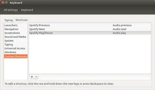

There is a simple solution credit goes to this thread on Spotify forum, Thanks to schuellerf and rszabla. The solution is pretty simple and works on any Linux distribution.
  1. Download this file, extract it and make it executable chmod a+x spotify_control
  2. Place it anywhere you want, I'll assume that it is placed in Downloads folder
  3. Go to settings -> keyboard -> keyboard shortcuts -> custom shortcuts
  1. Add new shortcut by clicking the plus button, I'll override the default play/pause/next and previous keys because I only listen to music on spotify, If you need those shortcuts then assign different ones for Spotify
The command you see in the picture above is for 'play/pause' function
/home/your_username/Downloads/spotify_control playpause
The commands that are available
  1. /home/your_username/Downloads/spotify_control playpause
  2. /home/your_username/Downloads/spotify_control previous
  3. /home/your_username/Downloads/spotify_control next
  4. /home/your_username/Downloads/spotify_control play
  5. /home/your_username/Downloads/spotify_control stop
Please note that you have to do this
Because
~/Downloads/spotify_control playpause
That won't work, at least not in Ubuntu 16.04, unity desktop, the shortcut manager doesn't seem to understand the tilde ~

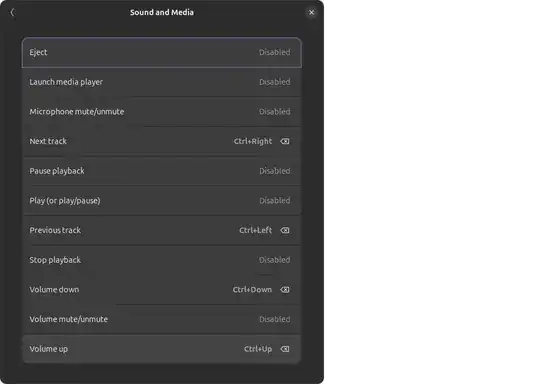

An easy way (Ubuntu 24.04): Settings -> Keyboard -> Keyboard Shortcuts -> View and Customize Shortcuts -> Sound and Media -> set the necessary shortcuts:
