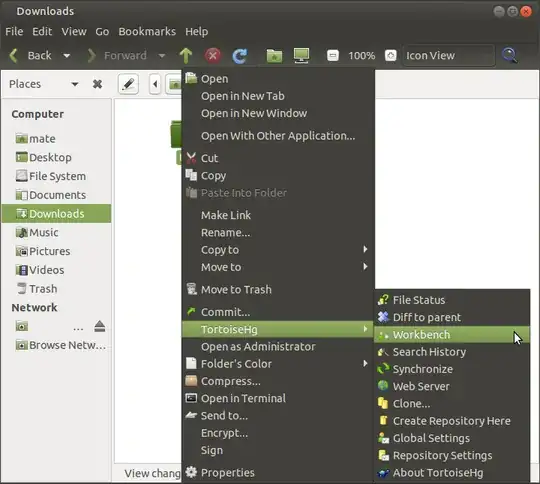

6. Install TortoiseHg extension for Caja
mkdir -p ~/.local/share/caja-python/extensions cp /usr/local/share/nautilus-python/extensions/nautilus-thg.py ~/.local/share/caja-python/extensions/caja-thg.py
and then restart Caja with caja -q && caja.
As the result one will get full functionality of Mercurial with TortoiseHG front-end in Caja:
  • the same emblems
    Caja with TortoiseHG integrated - emblems
  • and dropdown menus
    Caja with TortoiseHG integrated - menus
