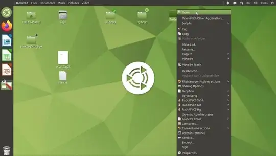

The below screenshot demonstrated all features of normal desktop integration between file-manager and desktop:
Fully-featured MATE desktop controlled by Caja
Here we have Mutiny panel layout and the following elements arranged by user:
  • home folder icon;
  • link to Dropbox folder (the folder itself is located in ~/Dropbox, controlled by caja-dropbox extension);
  • desktop shortcut to Caja application copied from menu;
  • pdf file with preview;
  • simple text file;
  • folder with Git repository inside (controlled by RabbitVCS extension);
  • folder with Mercurial repository inside (controlled by TortoiseHG extension);
  • simple folder with opened dropdown menu which demonstrates custom actions and menus from various extensions including custom caja scripts (usually located in ~/.config/caja/scripts) and actions configured using caja-actions-config-tool.

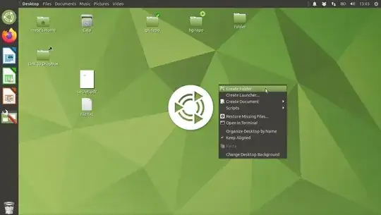

The screenshot of dropdown menu for empty desktop space is below:
dropdown menu alone above MATE desktop controlled by Caja
Note: above screenshots may be overloaded by the stuff, but they demonstrate how flexible MATE desktop is nowadays. You can compare them with default GNOME Shell and GNOME FlashBack to make conclusions by yourself.
