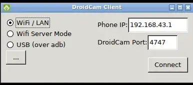

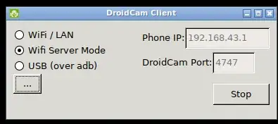

You could try to use DroidCam. I do not have PC with laptop in the one place, so I've just tested it on Android phone and Ubuntu 19.10. There's Wifi Server option present you could try in your case.
Installation for Ubuntu:
sudo apt install linux-headers-`uname -r`
sudo apt install v4l2loopback-dkms v4l2loopback-utils
sudo modprobe v4l2loopback
wget https://www.dev47apps.com/files/600/droidcam-64bit.tar.bz2 -O droidcam.tar.bz2
tar xjvf droidcam.tar.bz2
cd droidcam-64bit/
sudo ./install
echo -e '[Desktop Entry]\n Version=1.0\n Name=DroidCam\n Exec=droidcam\n Icon=droidcam\n Type=Application\n Categories=Application' | sudo tee /usr/share/applications/droidcam.desktop
You could run it from terminal: droidcam &
Allowing it in firewall:
sudo ufw allow 4747
For 20.04 this droidcam installation guide could not work. But I've found a different way described here.
