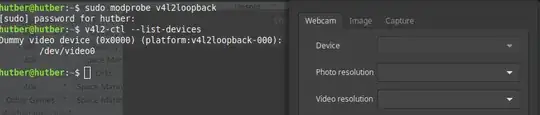

However this errors to create the dummy device, that at the same time is not accessible
hutber@hutber:~/v4l2loopback-master$ v4l2-ctl --list-devices
Dummy video device (0x0000) (platform:v4l2loopback-000):
    /dev/video2
Failed to open /dev/video0: No such file or directory
I would like the /dev/video0 to be available to use as a webcam and believe the issue lies somewhere in the v412.
[Edit]
After restarting the machine I now see:
hutber@hutber:~$ v4l2-ctl --list-devices
It says there is a Dummy Video Device, but I cannot see any devices when trying to use the dummy video.

Two potential problems:
  • Wrong video number. The number can change depending on the number of existing webcams. Check output of ls /dev/video* or v4l2-ctl --list-devices.
  • v4l2loopback module is not enabled or installed. If you already installed v4l2loopback run sudo modprobe v4l2loopback. Then check output of ls /dev/video* or v4l2-ctl --list-devices. If you did not yet install it see Is there any way ffmpeg send video to /dev/video0 on Ubuntu?.
Unknown V4L2 pixel format equivalent for yuvj422p
The V4L2 output device only supported a limited number of pixel formats. Add the format filter to your command to give it a compatible pixel format:
gphoto2 --stdout --capture-movie | ffmpeg -i - -vf format=yuv420p -f v4l2 /dev/video0
