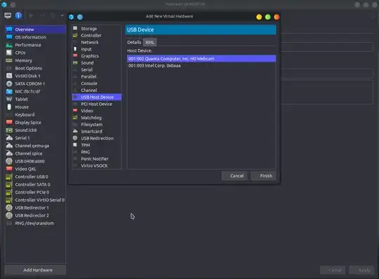

Based on the article that @user535733 posted in comments:
Open your VM, go to the Show virtual Hardware details menu (the blue "i" icon) at the top.
Click on Add Hardware -> USB Host Device -> Select your Webcam from the list -> Finish -> Apply your changes.
Boot your VM and the webcam should be working. The microphone support exists by default and no additional work is needed for that.
