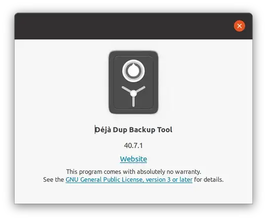

Here is how I just build it on Ubuntu 20.04:
  1. Clone source code
     git clone https://gitlab.gnome.org/World/deja-dup.git
    and cd ./deja-dup into the folder.
  2. Switch to older branch with gtk3 support for Ubuntu 20.04
    git checkout --track origin/40`
  3. Update whatever you want to change, eg. Improve full backup speed with Déjà Dup / Duplicity
  4. Make and install (including installing missing packages):
    meson . _build
    ninja -C _build
    ninja -C _build install
Voilà: custom compiled deja dup
