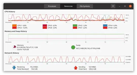

Especially the second issue means, that I can't use the full capacity of my Gigabit-LAN. Duplicity uploads the files with about 25 MiB/s. I upload manually a bigger file I get easily 80 MiB/s (NAS is connected with a 2 x 1 GbE bond).
Here is a typical screenshot of the System Monitor: screenshot system monitor gnome
Does anybody have an idea, how to improve the full backup speed? Eg. can I change the chunk size etc.

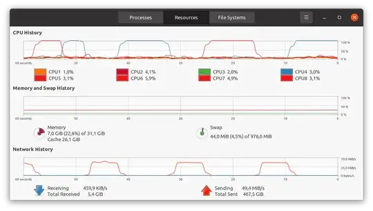

I just double-checked the speed of a full backup, it improved like 50% (from 24 to about 12 hours). Unfortunately, that is still not perfect as it packs each package and upload it before it starts the next one. But still better than before...
screenshot of improved upload in system monitor
